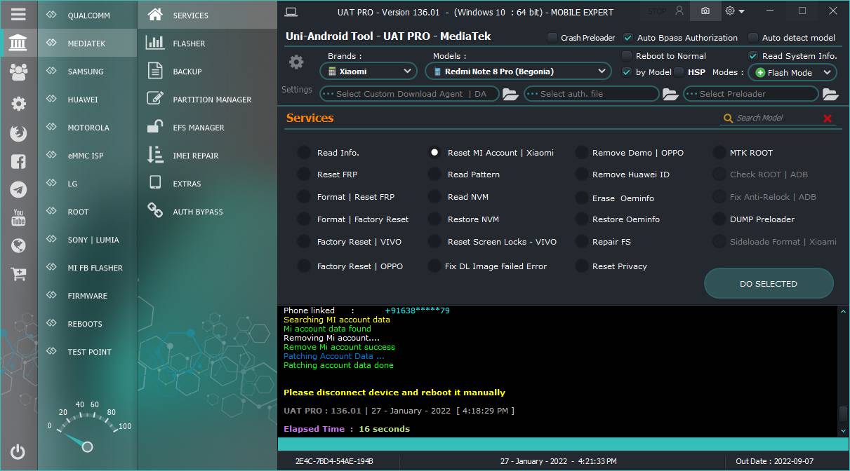

- Connection : Flash Mode
- Method : By Model
- Brand : VIVO
- Model : Y15 (PD1901)
- Process : Format | Factory Reset
Authenticating ... DONE
Initializing ... DONE
Waiting for device ...
Device found
MediaTek PreLoader USB VCOM (Android) (COM8)
Mode : PreLoader
Port : COM8
Preparing Download Agent ...
DA Version : MTK_AllInOne_DA_v3.3001.2018/03/20.21:08_402229+403250
Drivers : MediaTek Inc.
Driver Date : 01/22/2016
Driver Version : 3.0.1504.0
Handshaking : DONE
Loading Preloader : DONE
Booting device : DONE
Chip name : [MT6765]
Syncing with DA : DONE
Identifying Hardware ID ...
ChipID : MT6765
Software Ver : 0000
Hardware Ver : CA00
Secure Ver : 00
BootLdr Ver : 00
Ext RAM : 0x30000000
SRAM : 0x00040000
Storage : 0x0E91000000
RAM Size : 768.000 MB
SRAM Size : 256.000 KB
Storage Size : 58.266 GB
Storage Type : EMMC
Getting partition details : DONE
Partition count : 42
Reading system Information...
Android Ver. : 11
Android OS : Android 10 Q
CPU : arm64-v8a
Display id : RP1A.200720.012 release-keys
Build Date : Wed Feb 16 13:12:50 CST 2022
Build id : RP1A.200720.012
Security Patch : 2022-02-01
Product : k62v1_64_bsp
Local lang. : en-US
Searching for required data... DONE
Formatting device ... DONE
All successfully done
Please disconnect device and reboot it manually
If device stuck on Logo, please use recovery to wipe it and reboot
UAT PRO : 137.02 | 16 - April - 2022 [ 7:58:11 PM ]
Elapsed Time : 16 seconds
