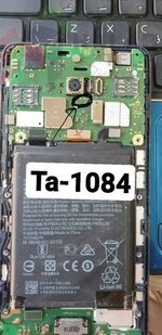

3- Remove the back cover of the phone and connect it with EDL mode, as shown in the picture To see the
image.
image.
