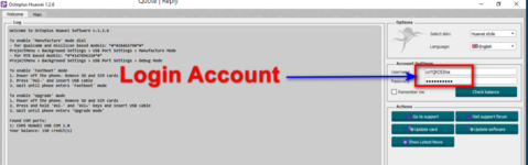

Login Username and Pass On Octoplus Huawei Tool

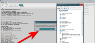

Huawei Com1.0 Close Error Fix with modified cable
Welcome to Octoplus Huawei Software v.‪1.2.7‬

Found COM ports:
1: COM7 USB Serial Port
2: COM29 Standard Serial over Bluetooth link
3: COM52 HUAWEI USB COM 1.0
4: COM28 Standard Serial over Bluetooth link
Job ID: 0000000001E2CB55
