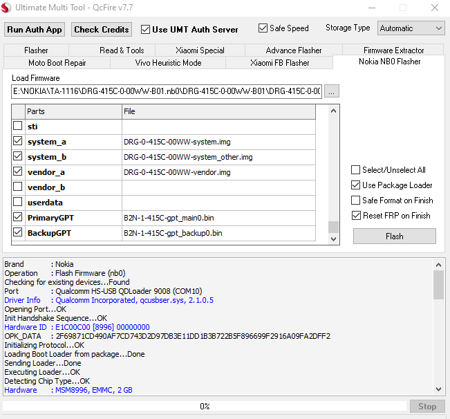

Nokia 6.1 Plus [ TA-1116 ] Hang On Logo Problem Solved
BY
Ultimate Multi Tool -UMT
Brand : Nokia
Operation : Flash Firmware (nb0)
Checking for existing devices...Found
Port : Qualcomm HS-USB QDLoader 9008 (COM10)
Driver Info : Qualcomm Incorporated, qcusbser.sys, 2.1.0.5
Opening Port...OK
Init Handshake Sequence...OK
Hardware ID : E1C00C00 [8996] 00000000
OPK_DATA : 2F69871CD490AF7CD743D2D97DB3E11DD1B3B722B5F896699F2916A09FA2DFF2
Initializing Protocol...OK
Loading Boot Loader from package...Done
Sending Loader...Done
Executing Loader...OK
Detecting Chip Type...OK
Hardware : MSM8996, EMMC, 2 GB
LU Count : 0
WARNING! High Speed Driver is not installed.
Please install driver from QcFire\Drivers folder using Device Manager.
Payload Info : In: 262144 [4096], Out: 131072, Sector Size: 512
Writing [B2N-3-415C-NON-HLOS.bin] -> [modem_a]...Done
Writing [B2N-0-415C-xbl.elf] -> [xbl_a]...Done
Writing [B2N-0-415C-xbl.elf] -> [xbl_b]...Done
Writing [B2N-0-415C-tz.mbn] -> [tz_a]...Done
Writing [B2N-0-415C-rpm.mbn] -> [rpm_a]...Done
Writing [B2N-0-415C-hyp.mbn] -> [hyp_a]...Done
Writing [B2N-0-415C-pmic.elf] -> [pmic_a]...Done
Writing [B2N-0-415C-keymaster64.mbn] -> [keymaster_a]...Done
Writing [B2N-0-415C-cmnlib.mbn] -> [cmnlib_a]...Done
Writing [B2N-0-415C-cmnlib64.mbn] -> [cmnlib64_a]...Done
Writing [B2N-0-415C-mdtpsecapp.mbn] -> [mdtpsecapp_a]...Done
Writing [B2N-0-415C-dspso.bin] -> [dsp_a]...Done
Writing [B2N-0-415C-abl.elf] -> [abl_a]...Done
Writing [B2N-0-415C-abl.elf] -> [abl_b]...Done
Writing [B2N-0-415C-BTFM.bin] -> [bluetooth_a]...Done
Writing [B2N-0-415C-mdtp.img] -> [mdtp_a]...Done
Writing [B2N-0-415C-sec.dat] -> [sec]...Done
Writing [B2N-0-415C-storsec.mbn] -> [storsec]...Done
Writing [B2N-0-415C-devcfg.mbn] -> [devcfg_a]...Done
Writing [DRG-0-415C-00WW-boot.img] -> [boot_a]...Done
Writing [B2N-0-415C-hwcfg.img] -> [hwcfg]...Done
Writing [B2N-0-415C-NV-default.mbn] -> [nvdef_a]...Done
Writing [DRG-00WW-001-sutinfo.img] -> [sutinfo]...Done
Writing [systeminfo.img] -> [systeminfo_a]...Done
Writing [DRG-0-0010-0001-hidden.img.ext4] -> [hidden_a]...Done
Writing [DRG-00WW-008-cda.img] -> [cda_a]...Done
Writing [DRG-00WW-008-multi-splash.img] -> [splash_a]...Done
Writing [DRG-00WW-008-splash.img] -> [splash2]...Done
Writing [B2N-0-415C-persist.img] -> [persist]...Done
Writing [NB1-0-4880-logfs_ufs_8mb.bin] -> [logfs]...Done
Writing [DRG-0-415C-00WW-system.img] -> [system_a]...Done
Writing [DRG-0-415C-00WW-system_other.img] -> [system_b]...Done
Writing [DRG-0-415C-00WW-vendor.img] -> [vendor_a]...Done
Writing [B2N-1-415C-gpt_main0.bin] -> [PrimaryGPT]...Done
Writing [B2N-1-415C-gpt_backup0.bin] -> [BackupGPT]...Done
Applying Patches................Done
Resetting FRP...Done
Setting Bootable Stroage Drive to 0...Done
Operation Finished.
QcFire Ver. 7.7
