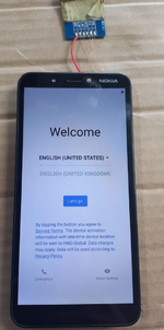

Nokia C2 TA-1233 | TA-1204 Flashing | Hang On Logo | Fix Restart Problem Done By Z3X Easy Jtag Plus
NOKIA C2 TA-1233 Flashing Done With Easy Jtag Plus

Part Name: 'L_MODEM'
File: ROM1_L_MODEM_0x000005B00000_0x000001900000.bin, Addr: 0x000005B00000, FileSize: 25.00 MB
Writing to Partition -> ROM1
Write Done. Count: 51200
Part Name: 'L_DELTANV'
File: ROM1_L_DELTANV_0x000007400000_0x000000100000.bin, Addr: 0x000007400000, FileSize: 1.00 MB
Write Done. Count: 2048
Part Name: 'L_GDSP'
File: ROM1_L_GDSP_0x000007500000_0x000000A00000.bin, Addr: 0x000007500000, FileSize: 10.00 MB
Write Done. Count: 20480
Part Name: 'L_LDSP'
File: ROM1_L_LDSP_0x000007F00000_0x000001400000.bin, Addr: 0x000007F00000, FileSize: 20.00 MB
Write Done. Count: 40960
Part Name: 'PM_SYS'
File: ROM1_PM_SYS_0x000009300000_0x000000100000.bin, Addr: 0x000009300000, FileSize: 1.00 MB
Part Name: 'BOOT'
File: ROM1_BOOT_0x000009400000_0x000002300000.bin, Addr: 0x000009400000, FileSize: 35.00 MB
Write Done. Count: 71680
Part Name: 'DTB'
File: ROM1_DTB_0x00000B700000_0x000000800000.bin, Addr: 0x00000B700000, FileSize: 8.00 MB
Write Done. Count: 16384
Part Name: 'DTBO'
File: ROM1_DTBO_0x00000BF00000_0x000000800000.bin, Addr: 0x00000BF00000, FileSize: 8.00 MB
Part Name: 'SYSTEM'
File: ROM1_SYSTEM_0x00000C700000_0x000076C00000.bin, Addr: 0x00000C700000, FileSize: 1.86 GB
Write Done. Count: 3891200
Part Name: 'CACHE'
File: ROM1_CACHE_0x000083300000_0x000009600000.bin, Addr: 0x000083300000, FileSize: 150.00 MB
Write Done. Count: 307200
Part Name: 'VENDOR'
File: ROM1_VENDOR_0x00008C900000_0x000012C00000.bin, Addr: 0x00008C900000, FileSize: 300.00 MB
Write Done. Count: 614400
Part Name: 'PRODUCT'
File: ROM1_PRODUCT_0x00009F500000_0x000006400000.bin, Addr: 0x00009F500000, FileSize: 100.00 MB
Write Done. Count: 204800
Part Name: 'ELABLE'
File: ROM1_ELABLE_0x0000A5900000_0x000001400000.bin, Addr: 0x0000A5900000, FileSize: 20.00 MB
Part Name: 'VBMETA'
File: ROM1_VBMETA_0x0000A6D00000_0x000000100000.bin, Addr: 0x0000A6D00000, FileSize: 1.00 MB
Part Name: 'VBMETA_BAK'
File: ROM1_VBMETA_BAK_0x0000A6E00000_0x000000100000.bin, Addr: 0x0000A6E00000, FileSize: 1.00 MB
Part Name: 'BACKUP_GPT_LAYOUT_ROM1'
File: ROM1_BACKUP_GPT_LAYOUT_ROM1_0x0003A3DFBE00_0x000000004200.bin, Addr: 0x0003A3DFBE00, FileSize: 16.50 KB
Write Done. Count: 33
Write Done..
Total Flash Partitions: 41
Checking Patches..
Patches Not Found, Trying Force Repartition..
Start Force Repartition..
Repartition for ROM1
Write Main GPT Done..
Write Backup GPT Done..
Repartition for ROM2
GPT Signature Not Found. Break..
Repartition for ROM3
Repartition Done..
Erase Google FRP..
Google FRP Signature Not Found..
Flash Done..
Elapsed Time: [00:22:08:188]
!!Warning! Partition Info in the Partition Tree is Deprecated!!
Please Re-Connect Device for Update Partition Info!
Reading Android Info
Partition #32 is '/system'. Mount..
Reading data..
Vendor = HMD Global
Brand = Nokia
Model = Nokia C2
Device = NBL
Name ID = Nebula_00WW
Android Version = 9
Firm Version = 00WW_1_120
Firm Date = Wed Dec 30 10:21:32 CST 2020
SDK version = 28
Locale = en-US
Time Zone = Asia/Shanghai
ID = PPR1.180610.011
CPU ABI = armeabi-v7a
CPU ABI2 = armeabi
CPU ABI LIST = armeabi-v7a,armeabi
CPU ABI LIST32 = armeabi-v7a,armeabi
Product = NBL
Product Hardware = k550_v1.1.0
Inc. Version = 00WW_1_120
Security Patch = 2021-01-05
Soft. Version = V1.120
Flavor = k550-user
Other Name = Nokia C2
FRP Path = /dev/block/platform/soc/soc:ap-ahb/20600000.sdio/by-name/persist
Desc. = k550-user 9 PPR1.180610.011 00WW_1_120 release-keys
