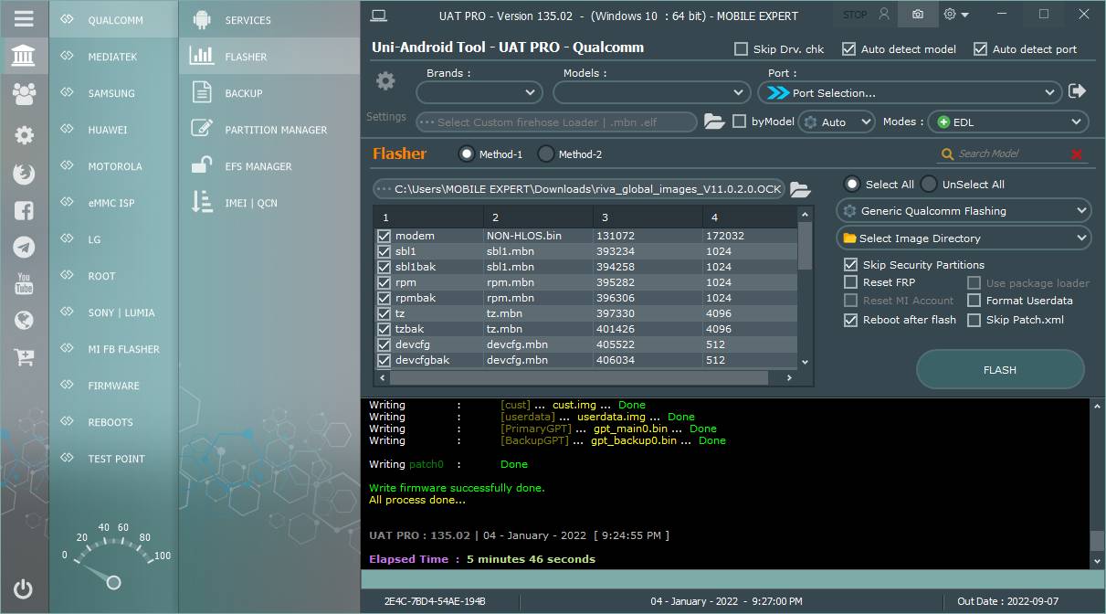

Redmi 5A Hang On Logo Problem Solved
BY
Uni-Android Tool - UAT

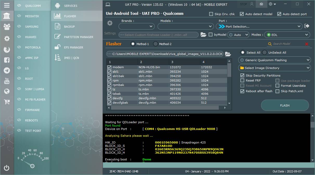

1. Power off device
2. Press and hold volume up + volume down insert usb cable
3. In some case requires special edl cable or test points
4. Install Qualcomm drivers if needed
- Connection : EDL
- Method : Auto detect
- Process : Flash
Waiting for QDLoader port ...
Port found
Device on Port : [ COM4 : Qualcomm HS-USB QDLoader 9008 ]
Analyzing Sahara please wait ...
HW_ID : 0001E065000 | Snapdragon 425
BLOCK_ID_S : F47AB10D
BLOCK_ID_H : 02603RNS6369Q23SQ7O8650RPR9QO63N
BLOCK_ID_H : 362N53NP119N0237N470S8SS3958Q84N
Executing boot : Done
Configuring : Done
Reading Parts : Done
Capacity : 29.12 GB
Userdata : 24.43 GB
Partition Count : 49
Drivers : Qualcomm Technologies, Inc.
Driver Version : 08/02/2017,2.1.2.7
MEM_TYPE : eMMC
Max_Payload_Size_InBytes : 1048576
Max_Payload_Size_Supp. : 1048576
Max_Bytes : 4096
Max_XML_Size : 4096
Version : 1
Target_Name : [MSM 8917]
Userdata : UnEncrypted
Reading Device Information...
Model : Redmi 5A
Hardware : QC_Reference_Phone
Android Ver. : 8.1.0
CPU : arm64-v8a
Software : Android_8.1.0_10
Android OS : Oreo
MIUI Version : V11
MIUI Code : 9
Platform : msm8937
Display id : CUSTOMER_VERSION_riva
Build Date : Tue Nov 5 23:20:03 WIB 2019
Build id : OPM1.171019.026
Security Patch : 2019-10-01
Brand : Xiaomi
Manufacturer : Xiaomi
Product : riva
Emmc Size : 16GB
Device Mod : riva_global
Local lang. : en-GB
Carrier : unknown
GsmVersion : 8.1_201812
Writing : [modem] ... NON-HLOS.bin ... Done
Writing : [sbl1] ... sbl1.mbn ... Done
Writing : [sbl1bak] ... sbl1.mbn ... Done
Writing : [rpm] ... rpm.mbn ... Done
Writing : [rpmbak] ... rpm.mbn ... Done
Writing : [tz] ... tz.mbn ... Done
Writing : [tzbak] ... tz.mbn ... Done
Writing : [devcfg] ... devcfg.mbn ... Done
Writing : [devcfgbak] ... devcfg.mbn ... Done
Writing : [dsp] ... adspso.bin ... Done
Writing : [splash] ... splash.img ... Done
Writing : [aboot] ... emmc_appsboot.mbn ... Done
Writing : [abootbak] ... emmc_appsboot.mbn ... Done
Writing : [boot] ... boot.img ... Done
Writing : [recovery] ... recovery.img ... Done
Writing : [system] ... system.img ... Done
Writing : [cache] ... cache.img ... Done
Writing : [cmnlib] ... cmnlib_30.mbn ... Done
Writing : [cmnlibbak] ... cmnlib_30.mbn ... Done
Writing : [keymaster] ... keymaster.mbn ... Done
Writing : [keymasterbak] ... keymaster.mbn ... Done
Writing : [cust] ... cust.img ... Done
Writing : [userdata] ... userdata.img ... Done
Writing : [PrimaryGPT] ... gpt_main0.bin ... Done
Writing : [BackupGPT] ... gpt_backup0.bin ... Done
Writing patch0 : Done
Write firmware successfully done.
All process done...
UAT PRO : 135.02 | 04 - January - 2022 [ 9:24:55 PM ]
Elapsed Time : 5 minutes 46 seconds
