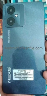

Walton Nexg N70 Fix Hang and Restart Problem Will Be Fix, After Flash Dead Hang Logo Blinking Display Will Be Fix if You Are used Wrong Version, After Flash Wrong Firmware Become Dead Show Only SPD Port, Keep Re Start & Show System Error Massage, Auto Recovery Mode & Auto Fast boot Mode Show Only, System Any Apps has been stopped Error Fix, unfortunately App has been stopped Apps error fix,
Brand Model Name
: Walton Nexg N70
Android Version: 12
CPU Type: Unisoc Tiger T606 Processor
File Size: 1.3GB​
Contact US & Call : +8801829776585
NEXG_N70_V12_20230717
