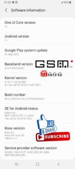

WORLD 1'ST EXCLUSIVE A127F A12 [Exynos 850] ISP PINOUT FRP RESET and DUMP FILE READ
